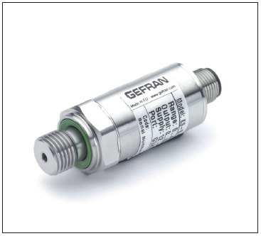

  25. #85
    Noniin, (jarru)paineanturi-uutuus tuli postissa.
    Eli kokonaan rosteria, halkaisija 22mm ja pituus 45mm + liittimet.
    Compact size (Ø 22 mm)
    Sensing element deposited on stainless steel diaphragm (NO o-ring, NO oil filling)
    All Stainless Steel construction
    Pressure range 0...200 bar (overpressure 400bar, pressure burst 600bar)
    Power supply 12...32V
    Output signal 0-10V (0-200bar)
    Output short circuit and reverse polarity protection
    G1/4 E pressure port with embedded o-ring
    <0.5% overall accuracy
    Response time <1 msec
    IP67 protection degree
    High mechanical shock capability, 1000g according to IEC 68-2-32
    Vibrations 20g according to IEC 68-2-6 and IEC 68-2-36
    Free mounting position
